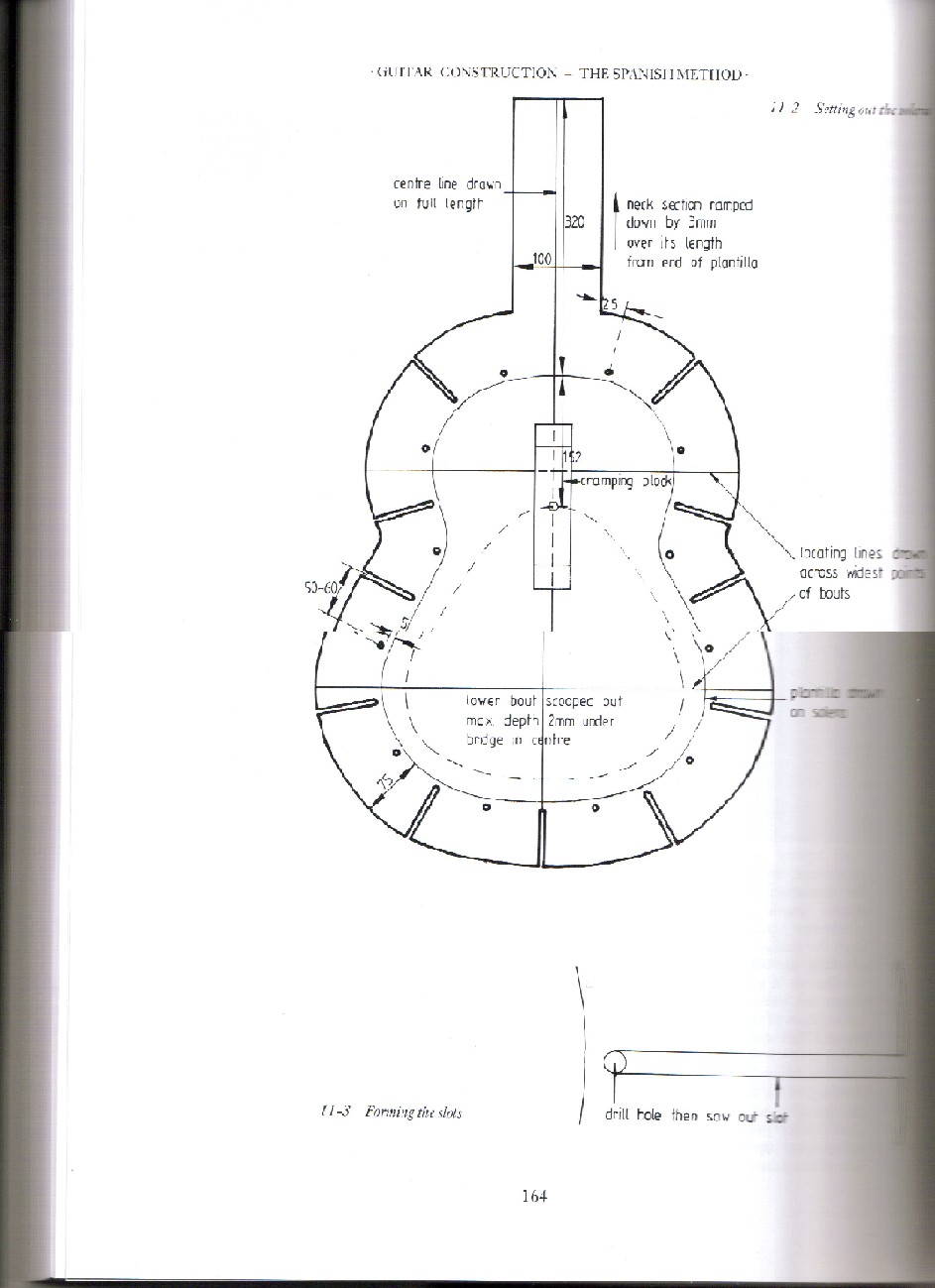

Russel, Graham is right. No radii are mentioned but there is a reason for that. Here is a picture of the solara plan from the book:
This plan indicates that the top plate is actually flat around the edges with the egg shaped area that encopasses the lower bout and the bridge area scooped out 2mm but not to the outside edge of the guitar. Courtnal does talk about this as a method of ensuring a good joint at the linings also.
I am a long ways away from knowing anything that I am talking about here but some of my classical building customers have told me that they will use 30 foot radius for the top and some will also use that for the back or may go to 25 foot for the back...just in case you want to use a dish, these are the radii I get orders for for the dishes I make and sell. The Fleta guitar is also almost flat in taper with the depth outside at 100mm at the tail, 98 mm at the tail end of the soundhole and 96mm at the heel.

I build in the spanish metod using a dished solera. In general a hand contoured solera looks mostly like what Courtnal depicted but there is no hard and fast rule as to how to radius the dish. It is not a consistent arc as would be done when using a radius dish in a go bar deck to brace and then sanding a radius into the sides to match as done with steel strings. Mine is contoured to within about about 10mm of the edge.
My side profile is straight for the top with the radiused section being roughly in the same area as shown in the drawing above.
I do use a 30'top and a 15'back as my guide for contouring braces but the way I build is that my solera has a depth of close to 4mm at the deepest point in the center. I use hot hide glue and do a rub joint pressing braces against the top into my solera and then hold each in place for about a minute or so until the hide glue sets up. There is some springback so what I end up with is about 2mm and is very close to a 30' top (although not a complete radius as mentioned above).
